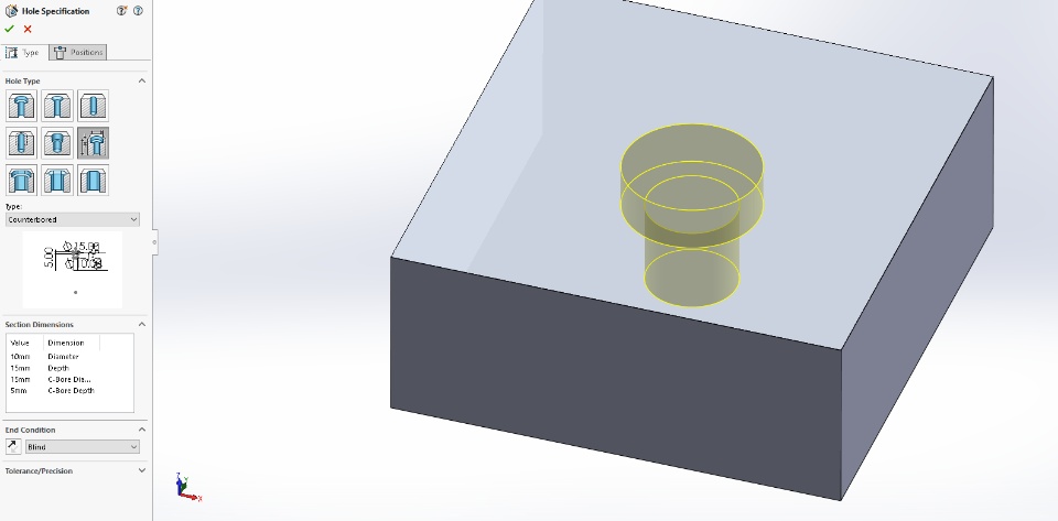

I came across an issue this afternoon, I tried using a legacy hole counterbore and the depth does not quite equal what I input.
Diameter is correct, counterbore diameter is correct, counterbore depth is correct, but for some reason the overall depth is changing to slightly (and annoyingly) undersize.

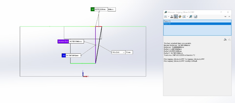

Now if I use the measure tool, I would expect it to show 15mm depth, except it is slightly under as it looks like it has calculated the 15mm depth as the minimum distance, surely this cannot be right? This stays consistent with whatever depth I enter.
