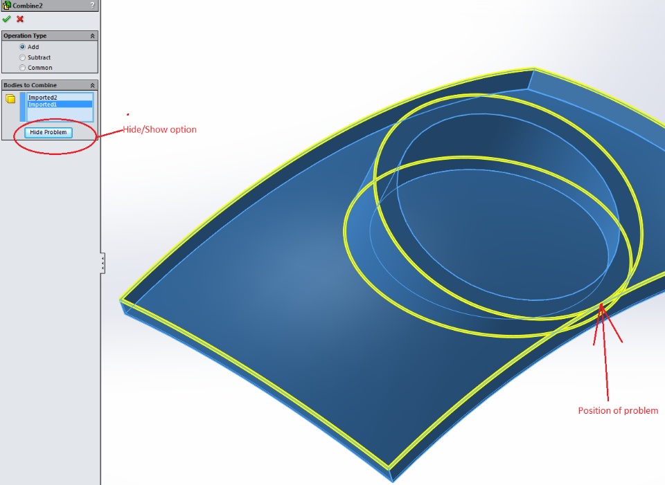

Have you seen the implementation of my (& others') long-awaited request to highlight Zero-Thickness geometry.  Hurrah! Thanks SW.
It is active when performing a Combine (see image attached of example part from SW).  One problem so far is that this has been implemented to show all the edges connected to the Zero-Thickness geometry. I was hoping for an arrow (or arrows) pointing to my Z-T geometry as per the Import Diagnostics arrow showing bad faces, etc.  Any thoughts other than it's better than nothing!
