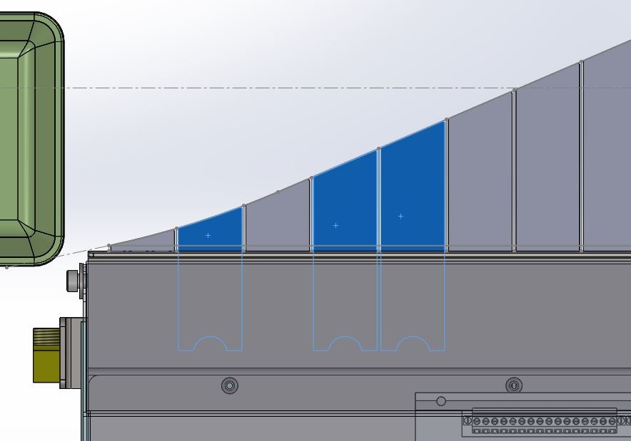

Here is a macro to LOCK/ UNLOCK external references on PRESELECTED components
My workflow often includes designing components in context and then locking external references. After years of manually locking/ unlocking each individual component I finally got around to make me a macro to do that on all preselected components as on the picture below.
Quick and dirty but it works for me.
And here is the macro:
