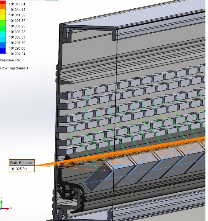

1-) We created static pressure on exterior surface [1] (101325 Pa) same as initial pressure.

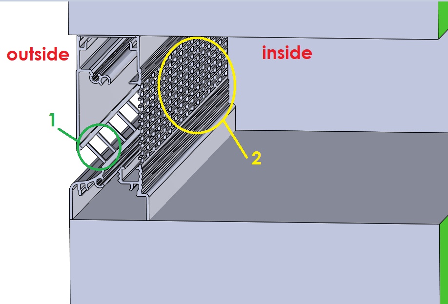

2-) For natural flow, we created enviromental/static pressure (we tried both separately) interior surface [2] . (101317 Pa)
and we used 2.5 million cells (meshing does not make any significant difference)
In both of these steps we created LID for each gaps (as shown in pic-2) and give boundary condition on their surfaces.

pic-1
pic-2
