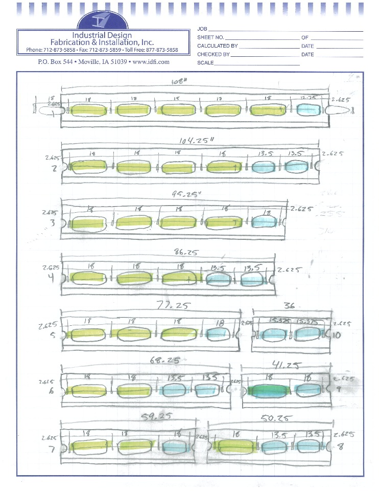

THE ATTACHED FILE IS A HAND SKETCH I CREATED FOR AN AUTOMATEDPART I NEED. ITS HIGHT IS IRRELAVENT. ITS MAX LENGTH IS 108". THEMIN LENGTH IS 36". ALONG THE LENGTH OF THE PART I NEED 13" SLOTS ON18" CENTERS AS SHOWN IN THE ATTACHED FILE. AS THE PARTS GETSSMALLER THE NUMBER OF 18" SECTIONS DECREASE THIS IS THE EASY PART.TO FILL THE REMAINDER OF THE PART THAT CANNOT SUPPORT A FULL 18"SECTION I HAVE PUT IN A SET OF SMALLER SLOTS. SOMETIMES ONE SOMETIMES TWO DEPENDING ON HOW MUCH SPACE IS LEFT OVER. NOTE THE PARTLENGTHS NOTED ON THE DRAWING ARE THE LENGTHS WHERE THE SLOTCONFIGURATIONS CHANGE THE ACTUAL PART CAN BE ANY LENGTH WITHIN THE72" RANGE UP TO .0000". IM LOOKING FOR A SIMPLE, EFFECTIVE, "SMART"WAY TO AUTOMATE THESE SLOTS ON MY PART. IVE LOOKED AT EQUASIONS,TABLES, AND PATTERNS AND HAVE NOT FOUND A GOOD SOLUTION. IF ANYONEHAS ANY SOLUTIONS TO MY PROBLEM PLEASE CONTACT ME ATMMULLEN@IDFI.COM THANK YOU.
