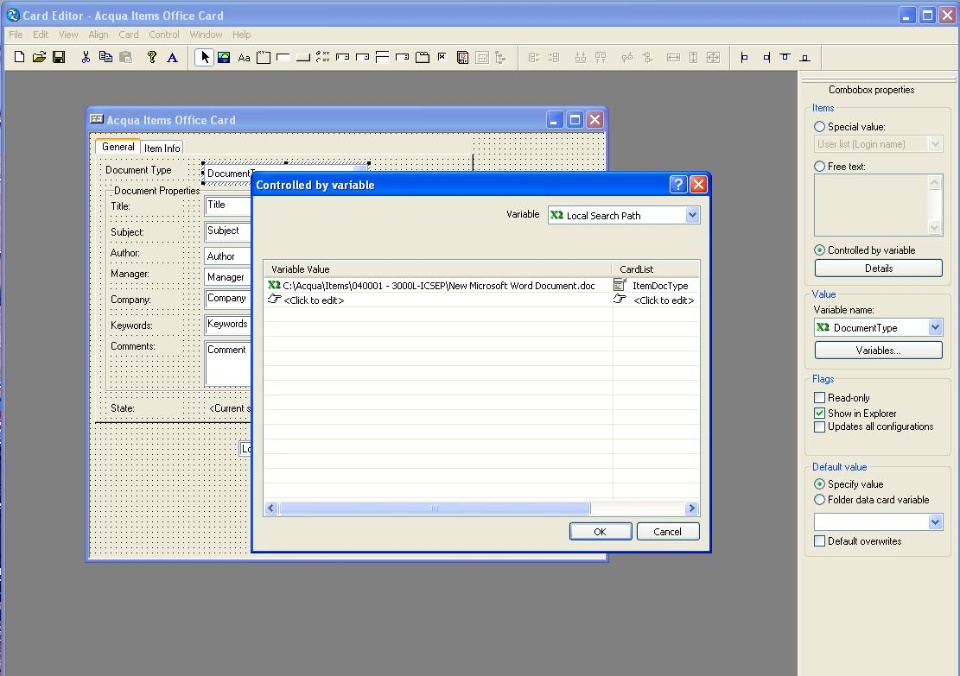

Please see attached file card, I am trying to create adynamic pulldown list in a file card. I would like to use adifferent listdepending which folder section you are in. I havebeen unable tofind any wildcards that work in this variable value,I would liketo use something like %item% or %\\item\\electrical\\%then I couldcreate cards that relate to the electrical area forexample. I needa file card for each section. The format of thesection is asfollows c:\\Vault name\\items\\Job Number\\ (Item that Iwant touse)\\Filename.ext
If anyone has Ideas please help
Thanks in Advance
