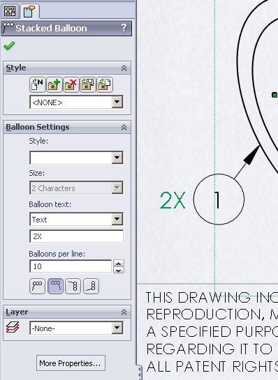

I am creating balloons on an assembly drawing and if thereare multiple instances for one part, I will add another notestating "2x" or "3x" and so on. I group these notes together withthe idea that they will move together. If I simply drag the balloonaround on the drawing they stay grouped just fine. If I update orchange and exploded view, the balloons for the part move but the"2x" does not. Is there any way to make these two notes move as agroup?SolidworksDrawings And Detailing
