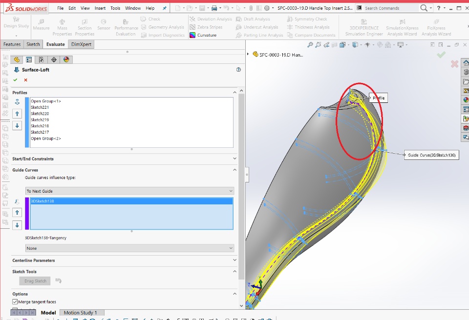

FYI: Selecting loft guide curve swaps control points

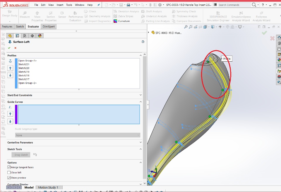

FYI: Many times I've encountered the problem that when doing a loft I will select the direction of the green control points (Figure 1) but when a guide curve is selected the orientation of some of the control points will swap (Figure 2) and I can't correct them afterwards. I've found that a undetermined combination of where you click on the guide curve to select it, the angle of the camera, and the zoom level changes how the control points swap. So hopefully if you encounter this problem yourself by changing the camera angle and where your click on the guide curve you may be able to find a orientation which doesn't swap the control points.
     Figure 1
     Figure 2
