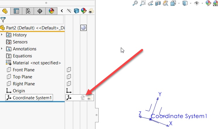

Of course the functionality can be further improved, so let's brainstorm on what would you like to see in the next service packs and future versions.
My Initial Suggestions for Future Improvement:
1. Allow users to apply colors to the coordinate systems. That would dramatically improve their visibility on the graphics area.
2. Make dimensions used in defining coordinate systems visible, selectable and editable in the graphics area. That would drastically improve user speed when revising the model.
Imagine, if you could, simply double-clicking on the coordinate system and its dimensions would pop-up on the screen. Then double-click any of them to edit.
3. Allow the numerical values used in defining coordinate systems to be driven by equations, custom properties or design tables. Adding this functionality will further enable users to automate their design.
4. Allow coordinate system planes to be used in the definition of the intersect feature.
5. Allow the patterning of coordinate systems.
6. Allow sketch dimensions to be attached to a Coordinate System's origin and axes.
7. Fix the bugs shown listed in the article above.
8. Add ability to redefine the Front/Top/Right default orientations based on a Coordinate System
9. When sketching on a Coordinate System Plane, allow the user to redefine the Horizontal and Vertical directions based on the Coordinate System. Thus, the Horizontal and Vertical relations could be used in the sketch.
