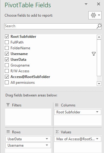

We wanted to audit all our users access to different permissions in our vault.  It's hard just going through the groups / users in PDM admin tool.

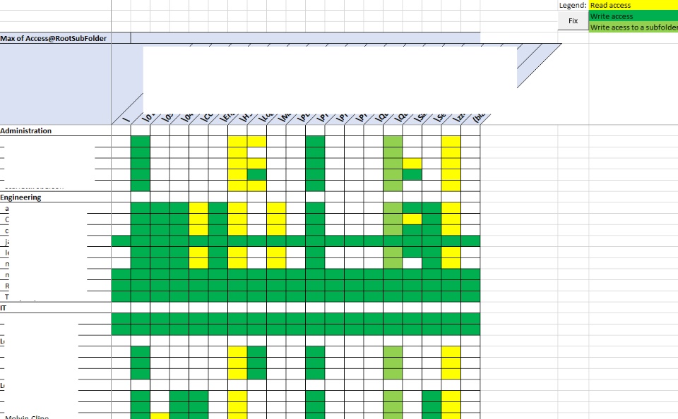

I couldn't find a good solution on line so came up with one, wrote a report generator query. It dumps all user and group permissions to all assigned folders in a big list.  Pretty easy to look at in a pivot table.
Might be of use to some of yall so sharing; see attached.  Good luck!
