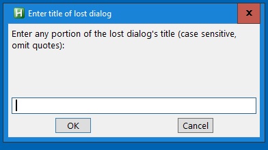

If you don't provide a title to search, this input dialog is displayed.
Enter enough text to match any portion of the title (or the entire title) and click OK to search or Cancel to abort.
As is shown above, the search is case sensitive.
Also, quotes are only required for command line input. Do not add quotes here.
For example, to find the dialog titled "Repair Sketch" (), enter "Repair" (without the quotes) and click OK.
These inputs will also work: Repair Sketch, Rep, R, Sketch, Sket
It finds the first matching window title, so provide enough text to be unique for what you want to find.
These inputs will not work: repair (doesn't match case), skech (misspelling)

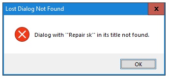

If the dialog isn't found, this dialog is displayed:
Review the text you entered (shown quoted) to see if it was what is required.
