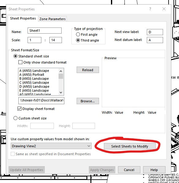

If you want to change the sheet properties on all the sheets at once, it still won't work.

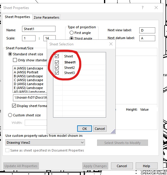

You select "All"
and "apply changes"
And switch to your other sheets, and they didn't change...
So you have to do it to each individual sheet.

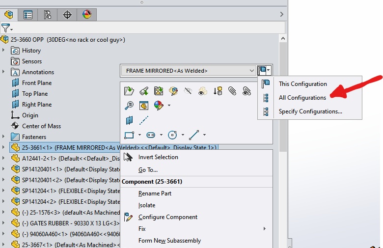

Also, similar issue when changing the config of a part in an assembly and trying to apply to all configs of that assembly... Still doesn't do it.
