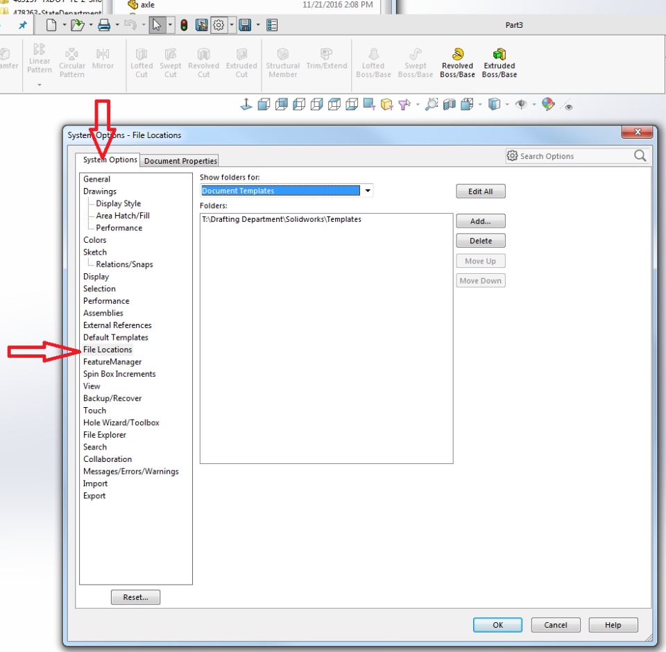

26. I've made some changes to a Part at Tools > Options > Document Properties, but when I start a new Part it reverts to the default settings. How can I use those in a new Part?
(Before I get started, the instructions I'm giving here apply to Parts, but the process is the same for Assemblies and Drawings.)
Open a new blank Part and make the desired changes. Go to File > Save, and choose Part Templates (*.prtdot) from the drop-down at "Save as type:".
Name the file appropriately and save. I'd strongly suggest saving it somewhere other than the default location in the SolidWorks installation folder so you won't lose it if you upgrade to a newer version. If you're in a multi-user environment you might want to save it to a network so it's available for other users. Next go to Tools > Options > System Options > File Locations > Document Templates.
Click on the "Add..." button, browse to the folder where you saved the template, and select it. I'd suggest deleting the default location that's there now, but that's up to you. Now when you start a new Part you should have the new template available to choose from. If you don't, and you see this...

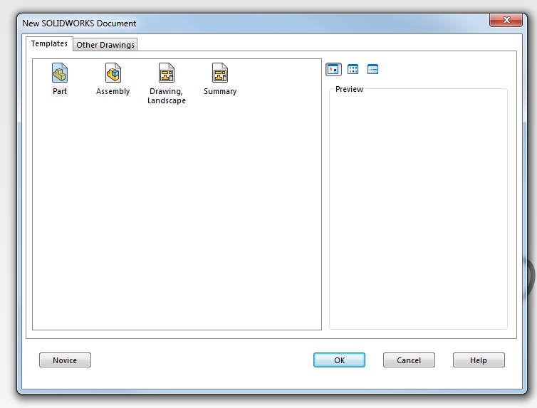

...which only has the default templates to choose from, click on the "Advanced" button at lower left. Then it should look something like this:
You only see one Part and one Assembly template here because that's all I need. Depending on your needs you can certainly have more. Just name them appropriately so you know what you're choosing. If you have a large number of document templates you can add sub-folders at the location you're pointing to at File Locations > Document Templates and these sub-folders will show up as tabs in the Advanced New Document dialog box. See above. "Templates" is my main folder that contains all my templates, and "Other Drawings" is a sub-folder. It contains some drawing templates that I rarely use but don't want to get rid of.

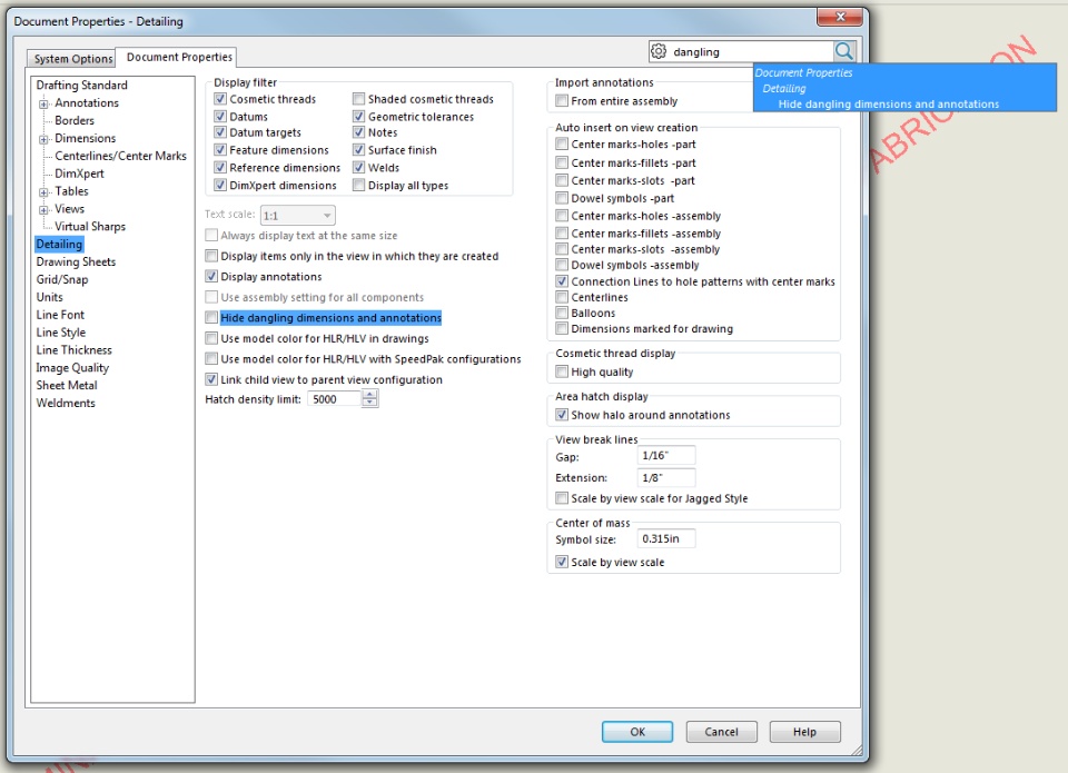

29. I made some changes to my model, and when I went back to the Drawing one (or some) of the dimensions have turned an ugly yellowish-brown color. What happened and how can I fix it?
That's referred to as a "dangling dimension", meaning it's lost its reference to the model Either it was referencing something that's no longer there, or something that's moved, or maybe your computer just hiccuped. If it had referenced a feature that was deleted then you'll obviously need to click on the dimension and delete it. If its reference just moved, you should be able to re-attach it. Click on the dimension to highlight it. There should be a small red box at the end of an extension line.
You should be able to click on it and drag it to the new reference. Keep in mind that you can only re-attach it to the same type of reference that was used to create the dimension. For example, if a model edge was used to create the dimension then you won't be able to re-attach it to a point or vertex. If you can't get it to re-attach, which sometimes happens, just delete the dimension and use the Smart Dimension tool to insert a new one. Occasionally a dangling dimension will appear to not be selectable (won't turn blue when you click on it), but when that happens I've always been able to click on it anyway and delete it with the Delete key on my keyboard. I've also run into a situation a time or two when a dimension would turn that color and appear to have lost it's references, but would be all blue when I clicked on it instead of having the red box. This seems to happen mostly when copying and pasting sheets from one drawing to another. When that happens I can still click on the box at the end of the extension line and re-attach it.
While I'm on the subject, notes and balloons (and other annotations) will sometimes lose their reference also and turn that same color. When that happens just click the end of the leader and re-attach it. The leader may still look like it's attached, but grab it and move it just a little bit. That should fix it.
There's a setting you can choose that will automatically hide these annotations, but I keep it turned off. If there's a problem with an annotation I want to know about it. If it just goes "poof" I very likely might not notice.

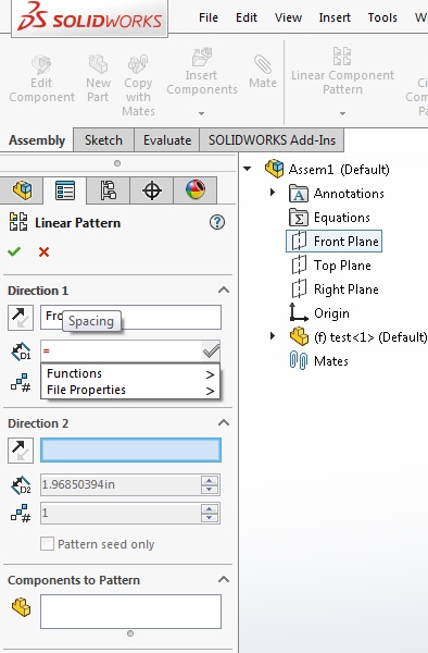

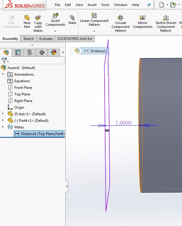

30. I have a Global Variable (or Custom Property, etc) that I'd like to link to in a Linear Pattern, Distance Mate, or similar feature that contains a dimension. Is this possible?
Yes. Some features, such as Linear Component Patterns in Assemblies, allow the use of Equations directly in the Property Manager (just type the Equal sign in the dimension dialog box, see below), but this was added fairly recently, so may not be available if you're using an earlier version, and still isn't available for all features.

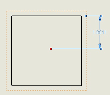

If you can't do it directly in the Property Manager, go ahead and create the feature, using a dimension that's close to what you need. Click Okay to close the feature, then single-click on it in the tree to show the dimension in the graphics area (or double-click if you don't have Instant 3d turned on).
Double-click on it to bring up the standard dimension dialog box, enter the Equal sign, and link to your variable, custom property, etc. You'll need to do a manual rebuild for the change to take effect.

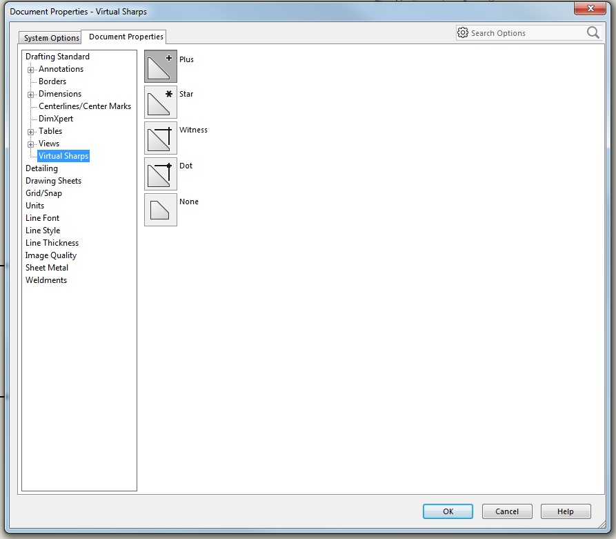

34. How do I dimension to the intersection of two edges, such as at a chamfer or fillet?
With the Smart Dimension tool active, right-click on one of the edges and choose "Find Intersection" from the drop-down.
Then click on the second edge. That will insert a Virtual Sharp at the intersection of the two edges, and establish it as the dimension reference. This right-click option is a fairly recent enhancement (SW2015, maybe?). If you're using an older version, then exit the Smart Dimension function, Ctrl+select the two edges, and then select the Point sketch tool. That will place a Virtual Sharp at the intersection of the edges, and now you can dimension to it. By the way, you can choose which of several styles you prefer for Virtual Sharps at Tools > Options > Document Properties > Virtual Sharps.
Unfortunately, there isn't currently (as of SW2017) a way to set a Layer or color for them. You can use a Layer to change the color if you don't like the default.

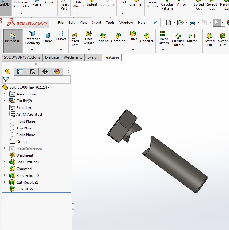

36. I have one Part interfering with another one in an Assembly and I want to use the interference to remove material from one of them. How do I do that?
In the Assembly, click on the one you want to cut and choose the "Edit Part" icon. That will allow you to edit this Part in the context of the Assembly.
Now choose the Indent command (Insert > Features > Indent). Select the Part you want to cut ("Target body:") and the Part you want to cut it with (Tool body region:), and choose "Cut".
Click on the Okay icon and you're done.

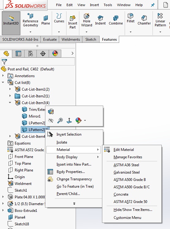

38. I have a multi-body Part, and I'd like to assign a different Material to one (or some) of the bodies. Is that possible?
Yes. Expand your Cut list folder all the way down to the body name. Right-click on it and Material should be there in the drop-down menu. After that it works just like selecting Material further down in the tree. If it's not there, then just like on pretty much every other SolidWorks right-click drop-down click on the little double-arrows at the bottom to get all available options.
