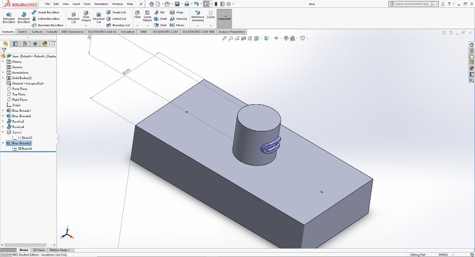

Hi,

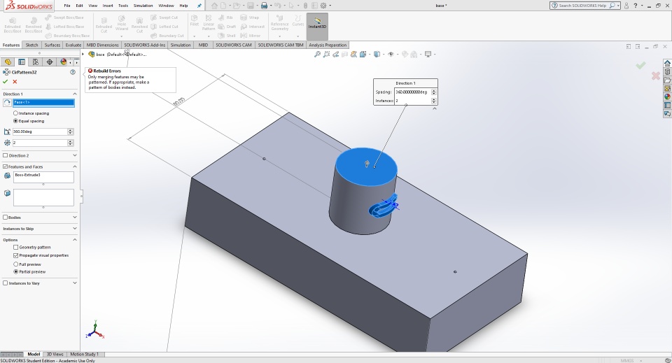

I tried to cir-pattern my Boss-extrude 3 to the opposite side, however, it showed I have to merge the part.
When I created the Boss-extrude 3, I did cancel the merge option, or I cannot create the part.
The curve sketch was project from the sketch not using wrap sketch.
I put my part in the attachment.
Please give me some help.
