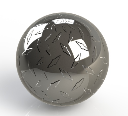

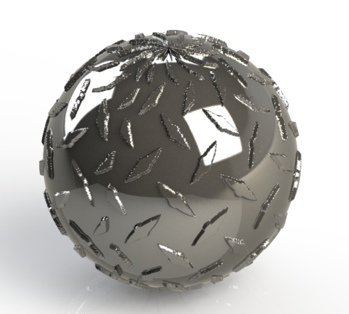

3.5.2.3. Use appearance surface finish to visually represent surface patterns like dimples, tread plate or knurling. Note that PhotoView 360 for SolidWorks 2011 supports bump mapping and now displacement mapping for surface finish. Displacement mapping is an effect where the actual geometric position of points over the textured surface are displaced (as opposed to perturbing the surface normals during illumination calculation as in bump mapping); the following images demonstrate the differences between the two. Note that displacement mapping consumes more memory and takes longer to render than bump mapping.
Figure 1 showing bump mapping for the diamond tread plate surface finish
Figure 2 showing displacement mapping for the diamond tread plate surface finish.
