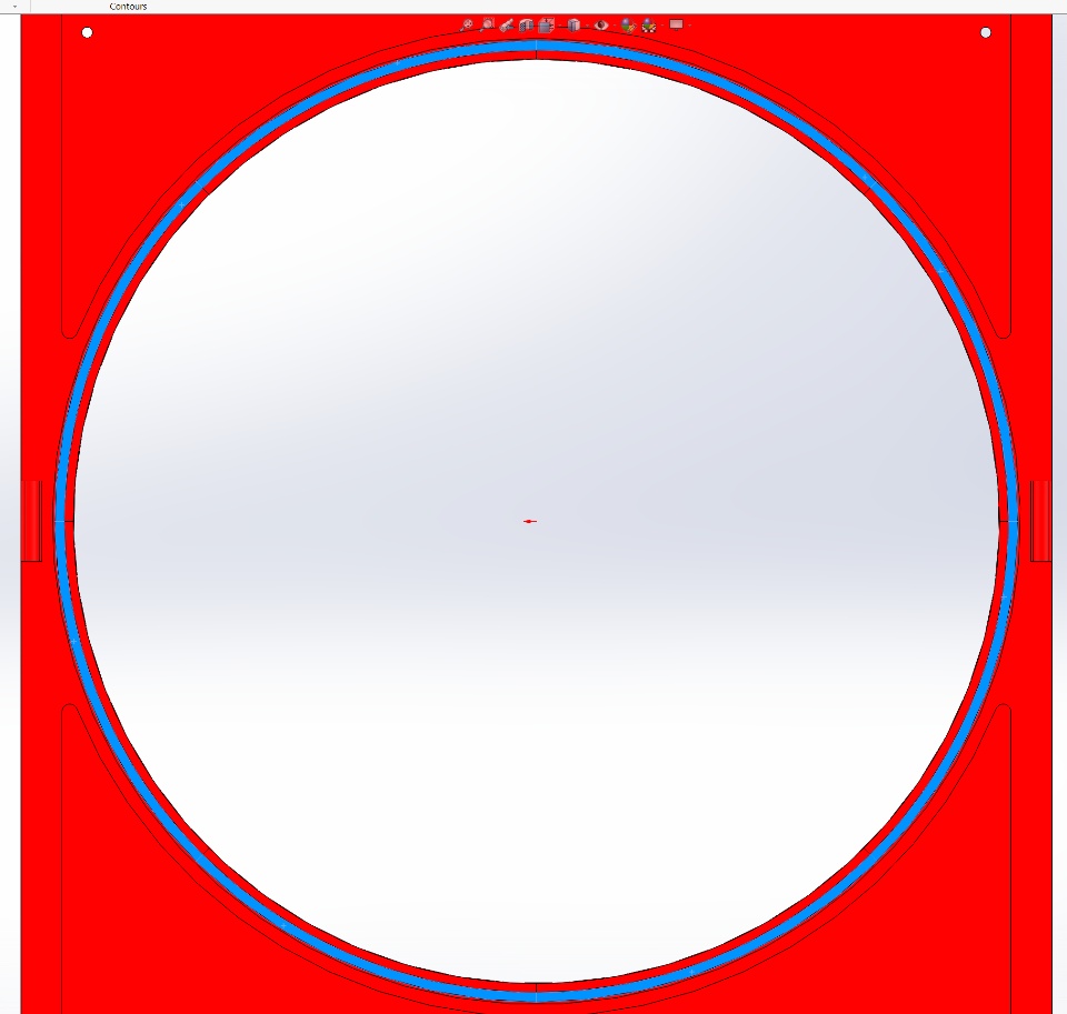

I have a model which includes a groove the follows a hyperbolic paraboloid path.
I need to cut a little material away from the wall to optimize it for an Expanded Polypropylene mold.
How do I get the cut to follow the bottom edge of this groove.
See attachments. The png shows location, the blue ring is the bottom of the groove.
