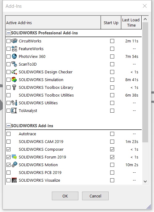

The startup time for Solidworks is around 1min. And for the add-ins, it takes really long time to load. For example, Simulation takes about 9mins, Toolbox takes about 7mins, and Motion Study takes over 10mins.

Is there any way to troubleshoot it? Thanks!
