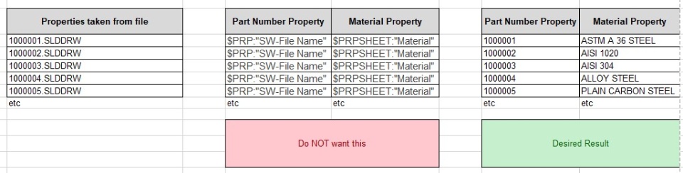

the problem comes when trying to extract these values into a spread sheet in order to provide a list of specific properties
as the text extracted is not the evaluated value see below for clarification:
In a perfect world, what I would like is:
  1. Run Macro
  2. Prompt user to select folder containing Drawing files that macro will run on
  3. Extract Evaluated Value of Property "Description" and Property "Part Number" from the first drawing
  4. Open excel worksheet
  5. Place evaluated values into worksheet
    1. Place First Evaluted value of "Part Number" into cell A1
    2. Place First evaluated value of "Material" into cell B1
  6. Open next drawing in list
  7. extract those values
  8. place evaluated values in the same worksheet in cells A2 and B2
  9. Repeat until all drawing files are processed
  10. User then saves that one worksheet at their desired location
