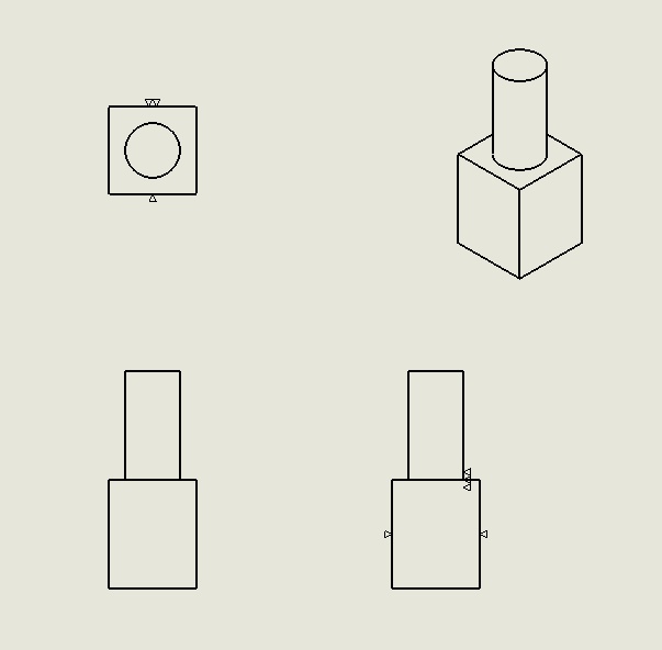

Part of my macro's functionality is to update existing machine mark annotations so that they agree with the values saved into the face to which they are attached. Those values could change after the annotations are created so it is necessary to traverse all annotations and update their style (single,double, triple nabla).
This worked fine until I started inserting machine marks on silhouette edges. With marks attached to silhouette edges, I'm getting type mismatch errors.
In order to determine which face a machine mark corresponds to, I need to call Annotation::GetAttachedEntities3. This function returns an array of entities. The type of those entities is obtained by calling Entity::GetType on each entity in that array or by calling Annotation::GetAttachedEntityTypes. The latter returns an "Array of longs or integers (see Long vs. Integer) that indicate the attached entity types as defined in swSelectType_e".
The bold line in the following function is where "type mismatch" is being thrown. Clearly I am checking whether or not this is an edge before attempting to assign it to swEntity.

Upon further investigation, I can see that there is no guarantee of correspondence between the types returned by GetAttachedEntityTypes and the type of the objects that are returned by GetAttachedEntities3.
a) I would expect this function to always return an array of entities. The fact that there are objects in that returned array that raise a type mismatch when I attempt to assign them to entities would indicate that the function was given the wrong name.
b) When the function manages to return actual entities, I would expect the order of entities returned to correspond to the order of types returned by the two aforementioned functions.
