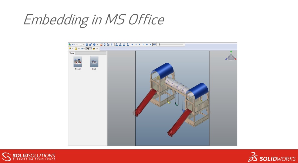

After creating a project in SOLIDWORKS Composer, how can you portray the details to clients in a meeting? With Microsoft Office you can directly embed the file directly into your document.

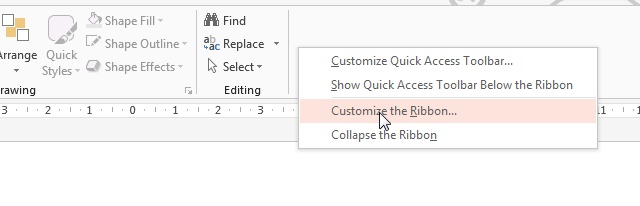

RMB upon the Dynamic Ribbon and choose Customise the Ribbon. Find Developer in the left column and choose ADD>>

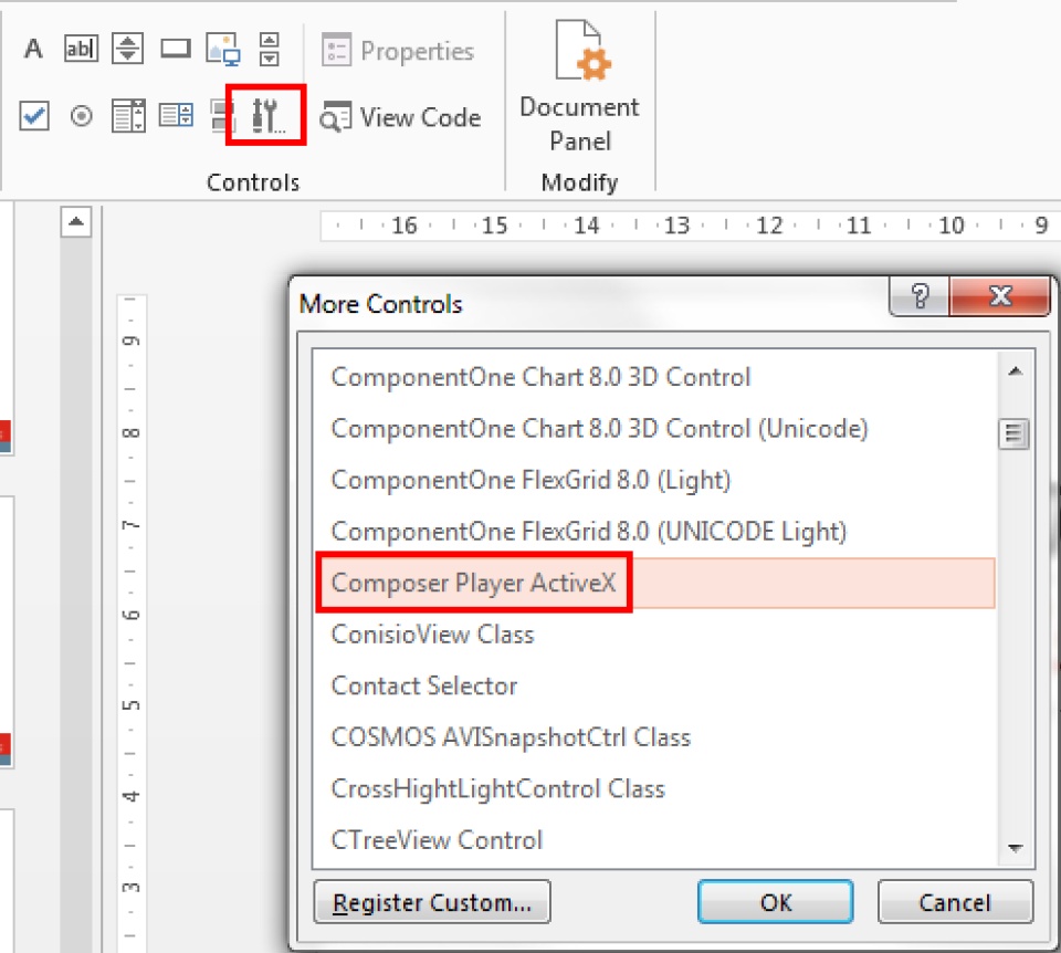

Select the Developer tab, choose More Controls in the Controls section. Then choose Composer Player ActiveX and draw a rectangle in the slide. The Composer Player ActiveX will have been automatically be installed as you installed Composer Player (part of the main SOLIDWORKS installation).

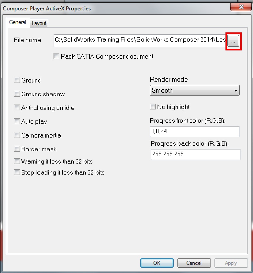

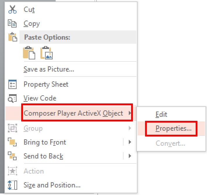

Once this has been added, RMB on the object and choose Composer Player ActiveX Object and Properties.
In the Properties dialogue box, point the program to the correct file. It can take all the different Composer file types (smg, smgXml, smgProj, smgGeom). There are also additional visual options that can be enabled, whether it is showing the Ground or Shadows.
This can be fully viewed within the SlideShow and any security settings applied to the file will still be valid within the viewer.
