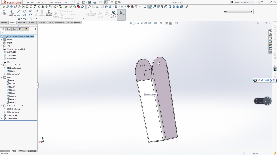

Here is an example:
A part which has no errors and originally looks like this, after one slight change in the first Boss-Extrude:

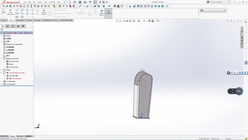

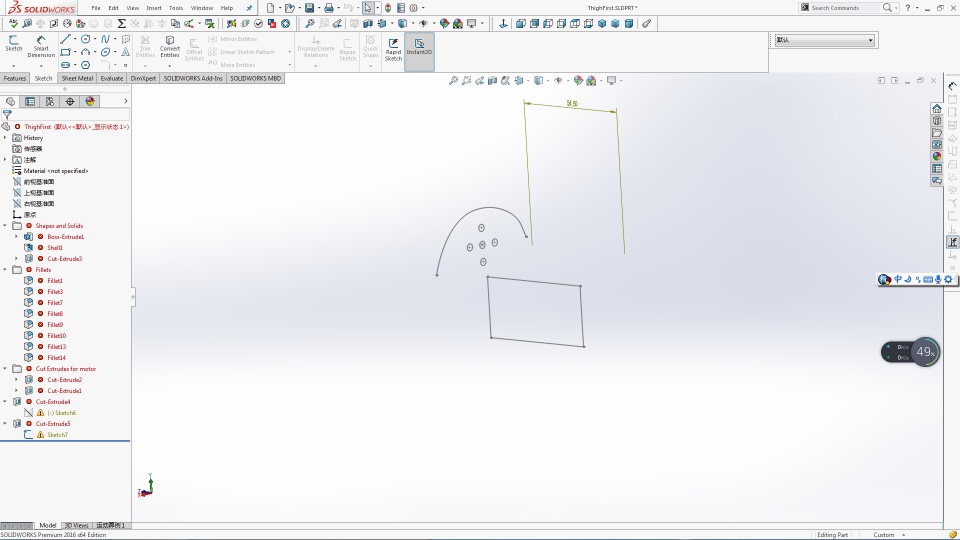

Now looks like this, with many errors and warnings.
This is incredibly annoying. This occurs when I replace a sketch entity in my initial boss-extrude sketch. Many times these errors force me to have to fix, or delete, if I am just too annoyed, working mates for no reason, which usually causes more problems in other assemblies that use the same part.

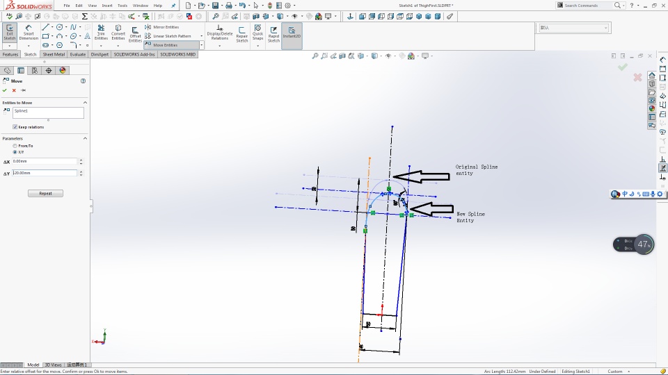

Anyway, whilst I don't have a solution to this annoying phenomenon, I do have a tip, that is, to replace sketch entities as little as possible. For my specific scenario, I wanted to reduce the height of my part. As my initial boss-extrude was mainly under-defined spline sketches, it was quite difficult to achieve this without what I did differently the second time was I simply did not replace the sketch entity. Instead, I deleted constraining dimensions and used move entities. This worked in some cases, like in the one shown above. I thought this was a much easier way.
Surprisingly this worked without much question. My Solidworks page instead looked like this.

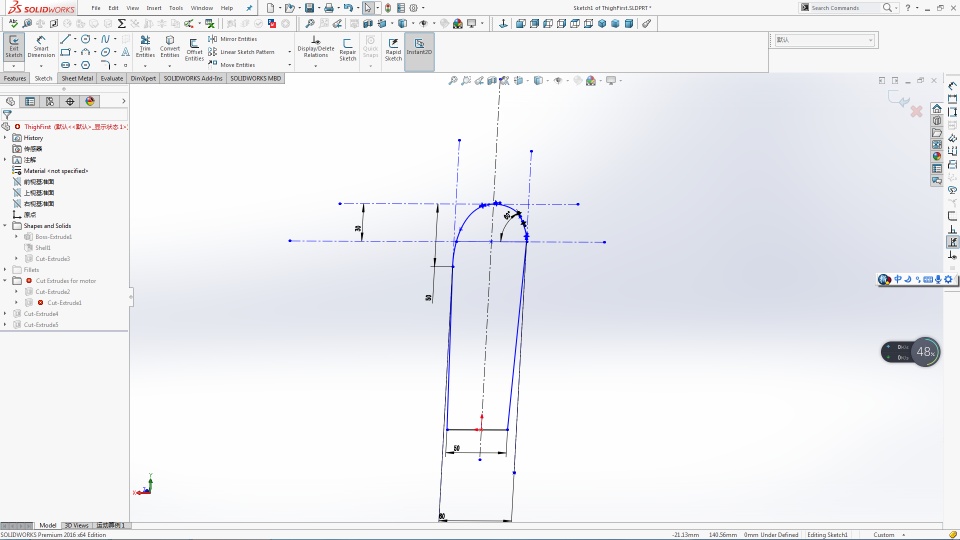

It was still erroneous, but there were a lot fewer errors than the previous case.
All in all, with a base sketch like the image below, if you want to change critical dimensions such as the height and the width of the part, using move entities to keep relations, especially when dealing with underdefined splines, might be very helpful for you.
