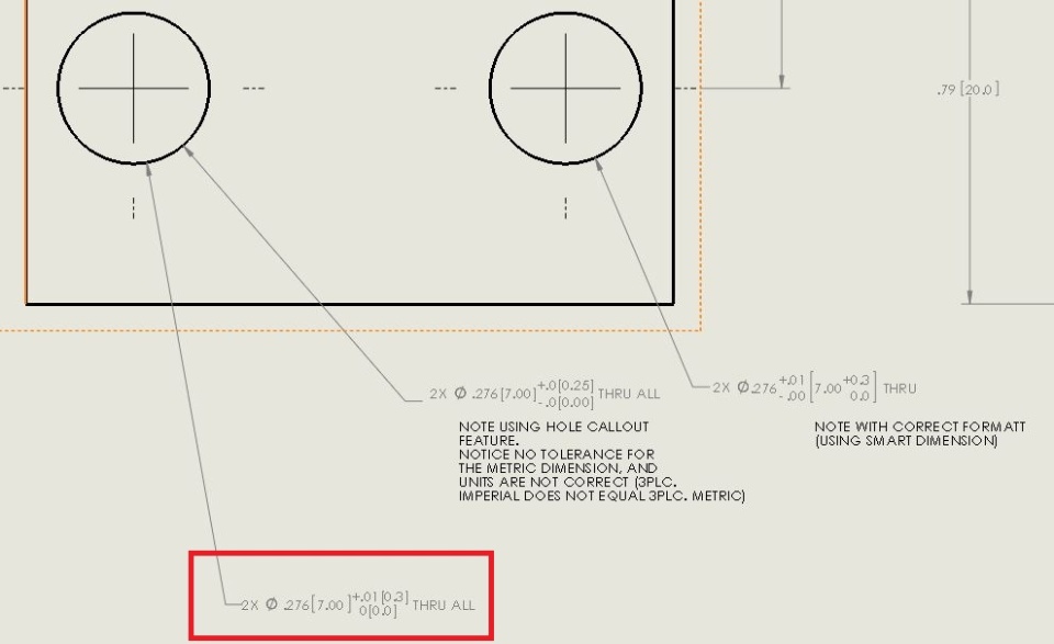

I am trying to make the precision different for the primaryanddual dimension for hole callouts.

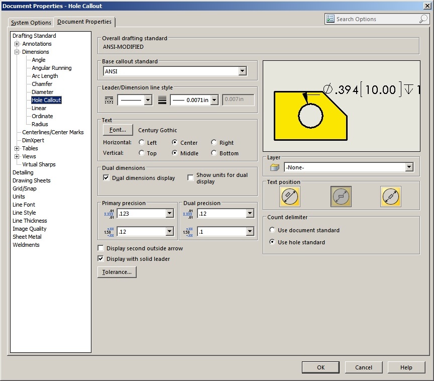

I have the "Dual dimension" option checked in the holecalloutproperty manager. I click "More Properties...">> "Precision" and change the Primary dimension to oneplace andthe dual dimension to two places but it doesn't changeeitherprecision?  It seem the precision in the"Tolerance/Precision"area on the first page of the hole calloutproperty managercontrols both primary and dual precision.
I use these same settings to control the precisionsindependentlyon regular dual dimension all the time. But I can'tget them to workwith hole callouts!
What am I missing?
