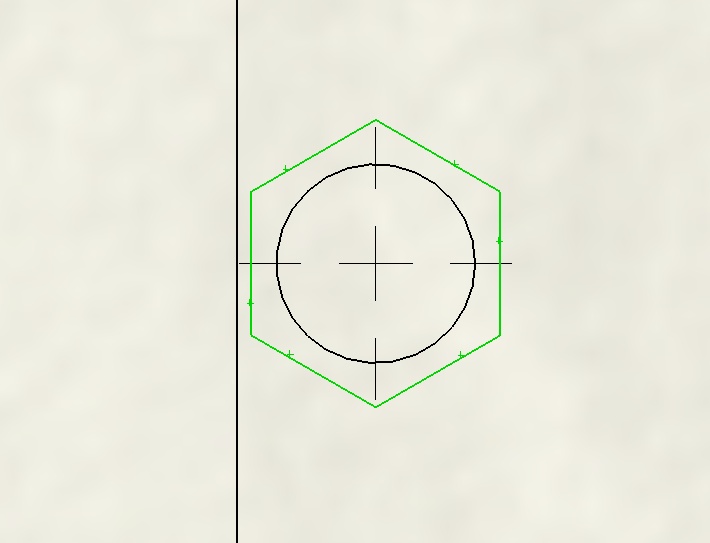

I have a drawing view of a sheet metal flat pattern. Typicalpractice here is to show scribed edges as a yellow phantom line. Ihave put together a macro that will turn the selected lines intoyellow phantom.
I would like to take this a step further. I would like to select aface in a drawing view. The external edges should be selected andthen changed to phantom yellow by the macro.
I guess what I am asking is can someone help me get the selectedface from a drawing view and select the external edges. I havetried a few things and have looked in the API help, but I have hadno luck.
I have attached an image of a sample.
