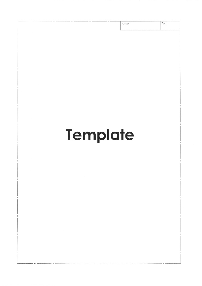

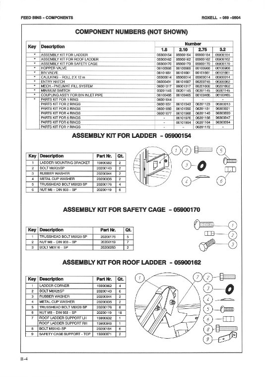

We have a drawing template A4 portrait in SW that we use tomakeour intruction manual views on in SWOn the pages in ourinstructionmanual (program=Quicksilver/Interleaf) we have a defaultrectangleframe (border) were we put the drawings (views), text ....withinInour SW template we have made the same rectangle frame tofit ourviews, text within, after the drawing is done we save ourtemplateas a .PDF file so my college can use it for her instructionmanualsbook.The problem is when my collge imports the .pdf that wehavetwo rectangle frames in the manual that we do not want.Is thereaway when the drawing is finished and before or while saving to.pdfthat the rectangle frame on our template is automaticly removedorhidden ?SolidworksDrawings And Detailing
