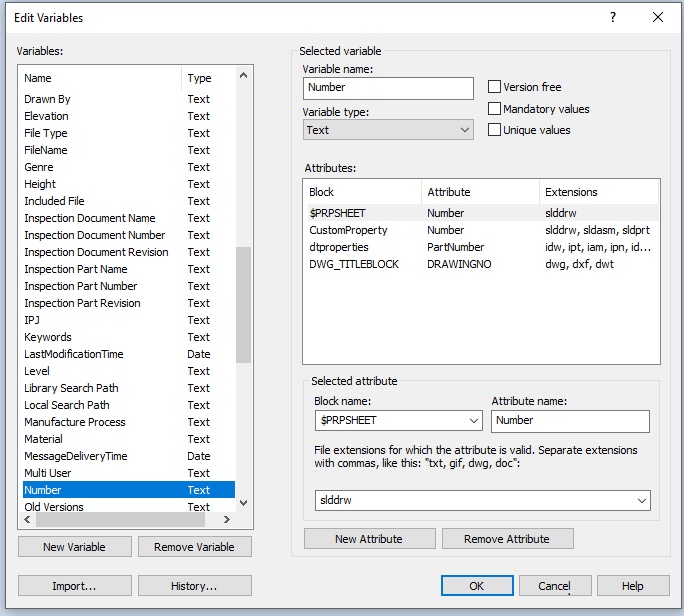

I am trying to set up the data cards in our company's PDM PRO. I can't get the properties of the drawings linked to the Custom Drawing Data Cards I have created.
I have set the attributes of the properties "Number" and "Description" as shown bellow :
But I am getting this as a result :
On the model I have a part that has many configurations. Each sheet represents a different model, so it has a different Number and Description.
Is there any way I can gat the data mapped to the different sheets and not only in the first one?
