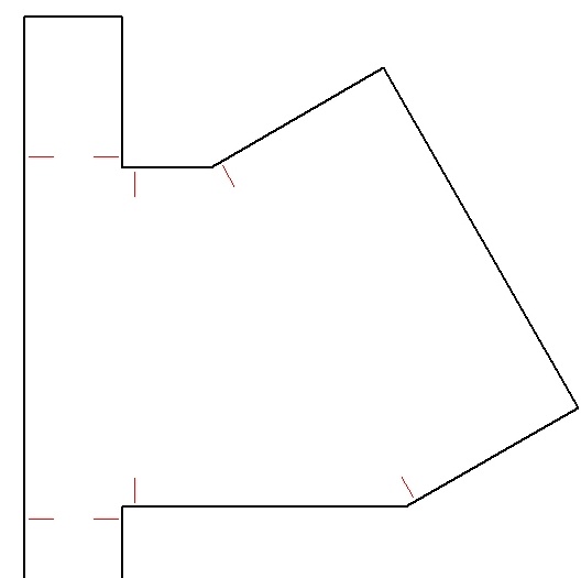

Hi everyone,
This macro will draw small red lines at each bend lines extremities on a sheet metal drawing.
It is based on John Alexanderreply on this thread:
it will work with rotated views and bend lines with angles.
