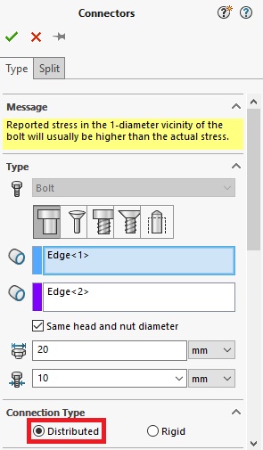

Here is new PropertyManager for the Bolt Connector, showing the Distributed and the Rigid options for the Connection Type:
From Pg. 160 of the What's New document:
Distributed coupling allows the faces attached to pin and bolt connectors to deform, which delivers a more realistic representation of a connector’s behavior. Distributed coupling for pins and bolts is available for linear static studies only
The distributed connection produces more realistic stress and displacement fields at a bolt's head and nut contact areas.

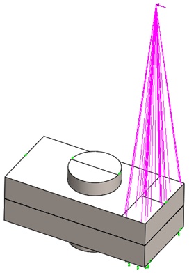

To do so, I will use a simple model with a pre-loaded bolt. A bolt tightens two plates, one of which also received a Remote Load. The bolt has a 10,000N axial pre-load. We shall compare the results using three modeling techniques:
  1. with a bolt represented with solid geometry,
  2. with a Bolt Connector using Distributed Coupling, and
  3. with a Bolt Connector using the Rigid option.
Note:
In the case of the bolt represented with solid geometry, a carefully chosen thermal load on the bolt shank creates the 10,000N axial pre-load.
See the Bolt Connectors 1.SLDPRT model in attachment.

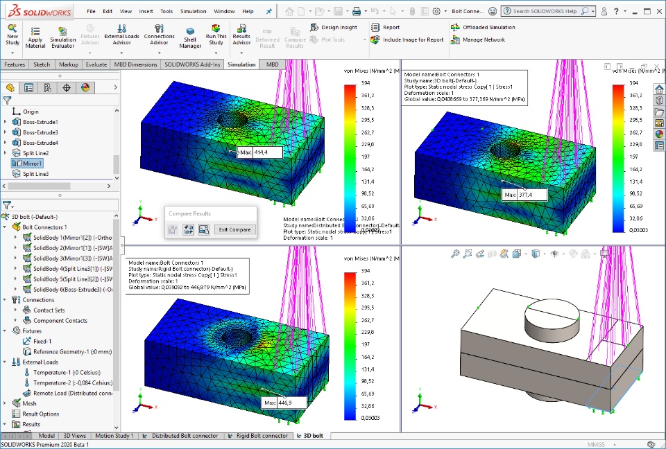

The screen capture below shows a comparison of the stress results on the plates for all three modeling techniques:
As you can see, the magnitude and the distribution of stresses are very similar for the top row (Distributed Bolt Connector and 3D bolt). The Rigid Bolt Connector gives different results due to the rigid bars in the formulation of the Bolt connector.

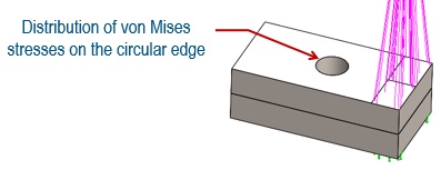

We can take a closer look. Compare the distribution of stress on the circular edge shown below between the study with the bolt represented with solid geometry and the study with the Bolt Connector using Distributed Coupling:
Solid bolt
Bolt connector with Distributed Coupling
As you can see the distribution shows the same pattern, and reaches the same maximum value of about 320 MPa in both cases. This clearly demonstrates the accuracy of the new Distributed Coupling option of the Bolt Connector. As a last note, it is worth mentioning that the solution time with the Bolt connector is about half that with the solid bolt. And the setup is much easier.
With the new Distributed Coupling option of the Bolt Connector, SOLIDWORKS Simulation sets a new high for ease of use and accuracy.
