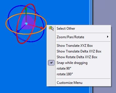

I was working on an assembly today and I noticed that when you are using "Move with Triad" you can right click on the "rings" that allow you to rotate a component and there is a "rotate 90" and rotate 180" - when did that happen?  I've used the triad to move and rotate freehand all this time and must have missed this option when it came out, but it's very helpful.
I thought that I'd like to share my day's discovery...
