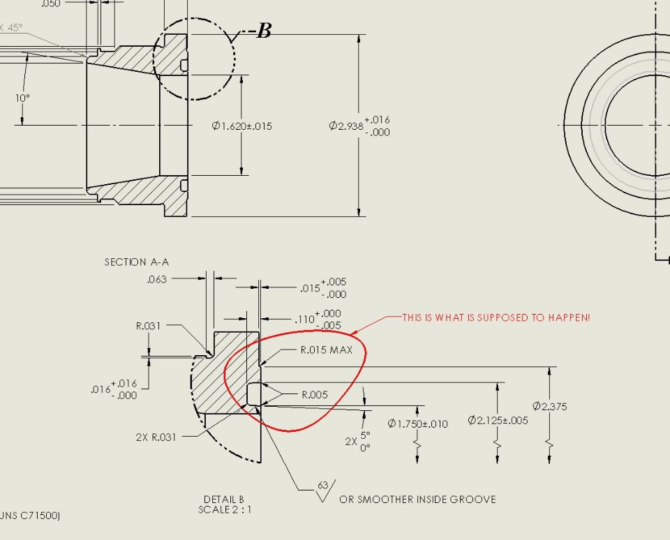

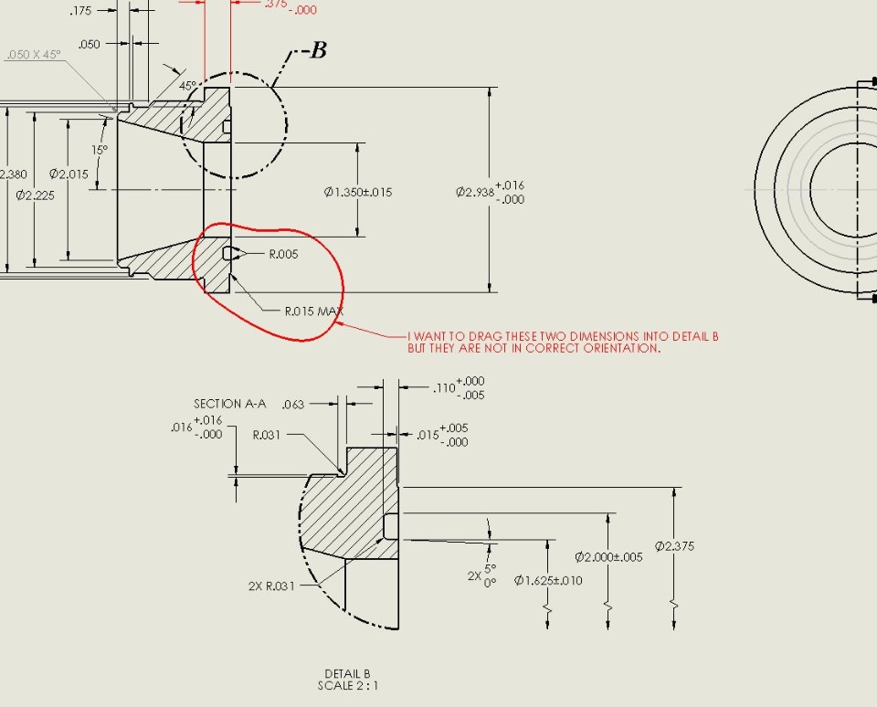

Anyone have any insight on changing the orientation offeature dimensions when inserting model items? The ones that seemto be the biggest pain in the butt are fillet dimensionsoriginating from fillet features. When I insert model items for afillet feature, they almost always show up in the incorrectorientation. ie.. i want them to show up in a detail view but theycome in on the wrong side of model and therefore wont drag intodetail view. I have tried redoing the fillet feature in the modeland it keeps coming back in the same f*&ked up orientation.I'll attach images. Images are from two different parts. One worksas expected. The other is a pain in the rear. Parts are modeled inseemingly identical ways.
