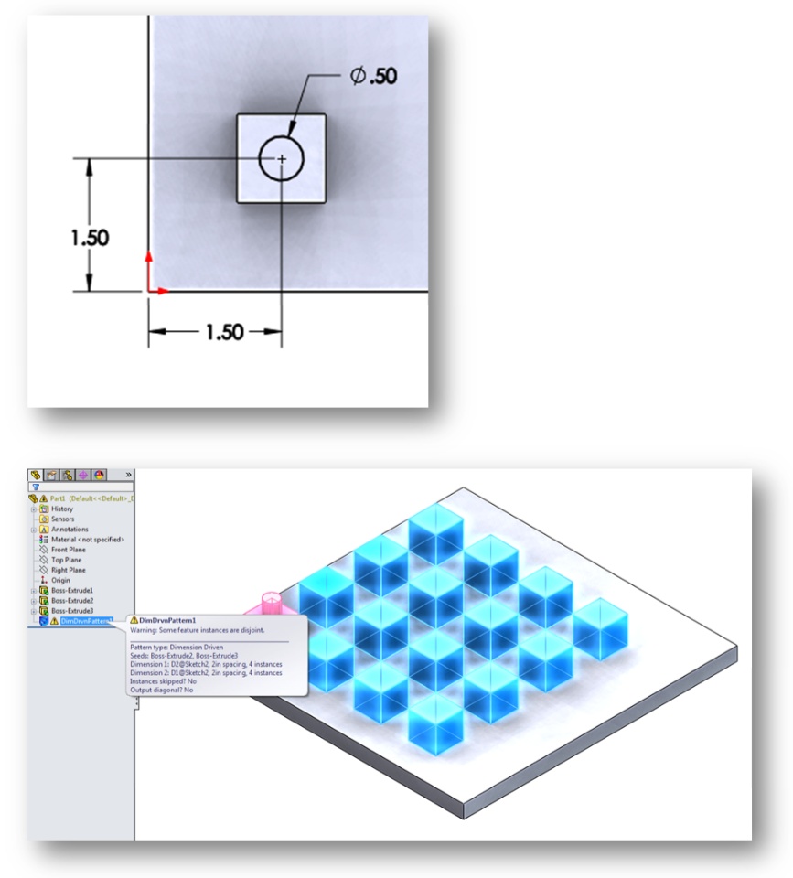

  • The instance must not form a separate body.  This means that the instance must be at least partially located on the planar or non-planar face.  If one instance of the pattern fails for any reason, the pattern may look like it has been formed properly but there will be a warning displayed on the feature in the FeatureManager.  We are working to improve this for Beta 3.

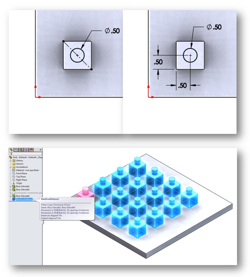

The images below show the results of improperly and properly constrained pin geometry, respectively. The improperly constrained geometry has the pin constrained to the edges of the main plate while the properly constrained pin is constrained to the boss (two different methods shown).  Both the boss and the pin are being patterned in these examples.

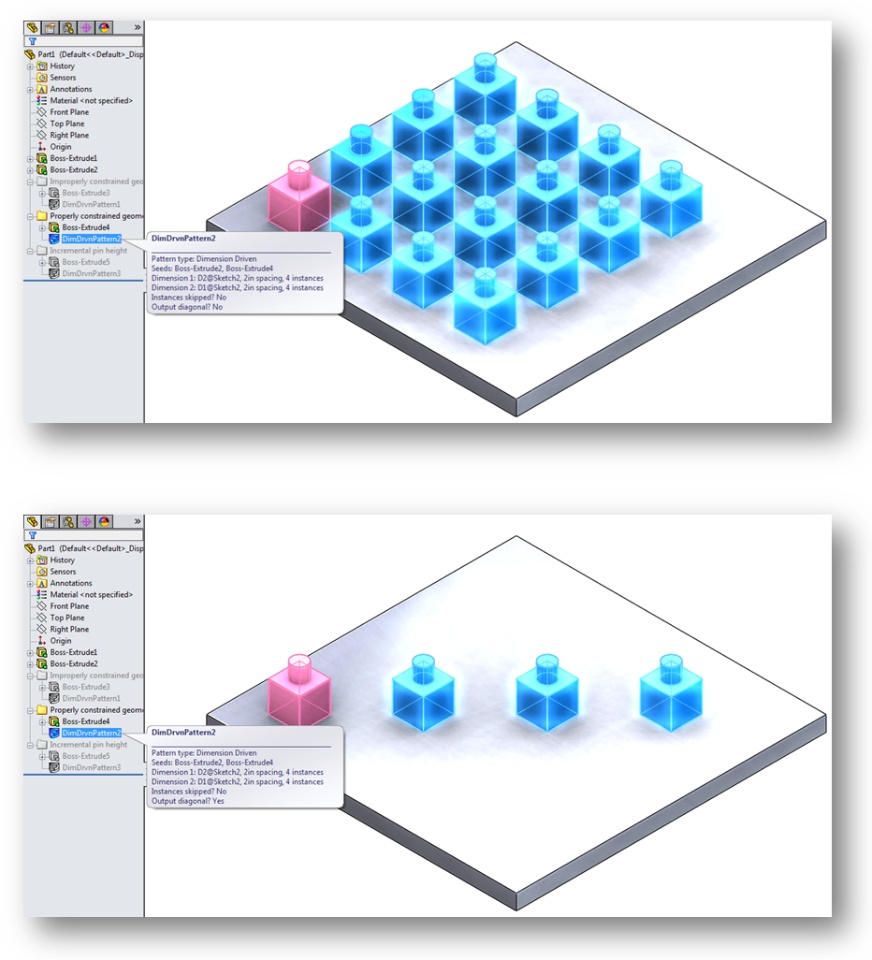

The images below show the results of what happens when the Output diagonal only option is disabled or enabled, respectively.  Think of the pattern instances as a matrix of locations [1, 1], [1, 2], [1, 3], [1, 4], [2, 1], [2, 2], … , [4, 4] and the Output diagonal only option as only creating the instances located on the diagonal of the matrix, i.e. [1, 1], [2, 2], [3, 3], and [4, 4].  If the resultant instance matrix is not square, e.g. a 3x4 matrix, the diagonal output will be that of the shortest side of the matrix, i.e. [1, 1], [2, 2], and [3, 3]

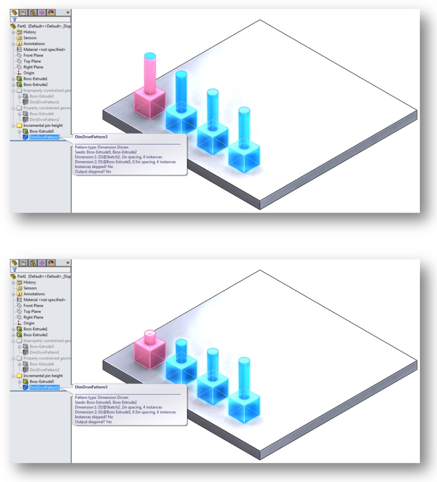

The images below show the result of selecting the X-offset value (1.00) of the square boss and the Z-offset value (0.500) of the pin and what happens when the Output diagonal only option is disabled or enabled, respectively.  Note that the pins in the first image (diagonal output disabled) are stacking each incremental length one on top of the other in the first image.  Look at the preview geometry when editing the pattern to see this better.

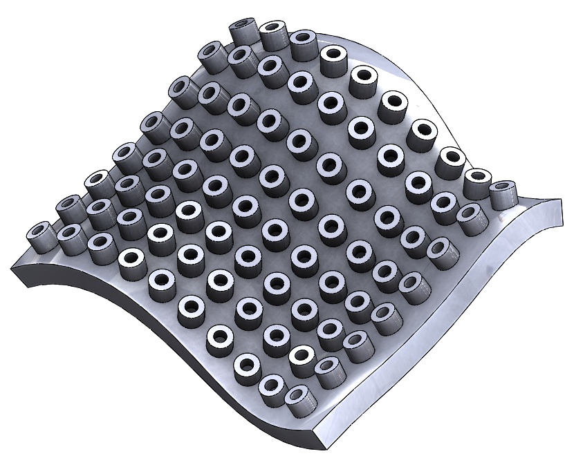

The examples shown above are very simple but you can create very complex pattern results when using non-planar faces with various end conditions such as the image below.
