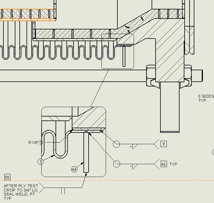

Major changes, minor changes, opening the drawing, or getting a cup of coffee all seem to make the detail view sketches change location. Simply dragging them back isn't too bad on a drawing that has only one or two, but the drawing I'm currently working on has over 20, and it's a pain. It only seems to crop up on larger drawings, but that could be because i spend much more time working on them. Any ideas?
SW 2019 SP 2.0
This view has moved to the left. The left vertical line should sit in the middle of the U shaped curve. Unfortunately since upgrading from 2015 i can't make the vertical sketch line coincident to the midpoint of the curve anymore.
