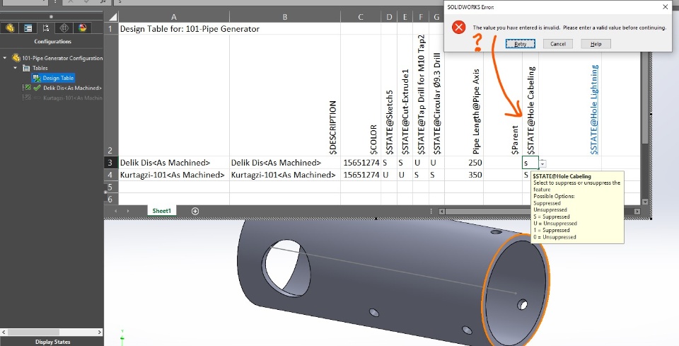

Need to figure out a way if it is possible to control two configurations and create a child configuration for each by using a design table.
For example, I have 101,6 x 5,74 mm pipe that I use in weldment profile and I tried to make several cuts, and for the other configuration, I used some hole drills.
So what I need to control is;
- Pipe diameter (as it is called from weldment profile maybe it is not suitable so you might want me to use custom solid creation..)
- Pipe length (which I figured by copying the primary value into the excel column to adjust)
- suppresing / unsupressing features
- Creating child config for each pre-made parent configuration that you will see in the SW 2020 file.
to do a feature suppression / unsupression (which I tried to do so but an error occurs immediately that prevents this situation as in the screenshot)
Hole spacings etc.
I also share my cad file that will give an idea.
My office might not be compatible with this as it is 360 and heard that 2016 works better on Solidworks, don't know why I cannot change the drop-down menus...
If my office have a problem maybe i should export an excel sheet and play with the options and import back to SW.
As i have plenty of these stuffs, this will be great if i can make this in only one part file in sw..
Hope there is some way for this other than creating multiple part for each pipe size and each feature that includes.. :)
