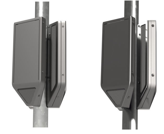

Has anyone else noticed a significant decrease in the render quality in 2019? Here are a few things I am experiencing. (the example below is the SAME file. The left image was rendered in 2018 the right rendered in 2019sp4):
  • Almost all curved surfaces are tessellated when a bump map is applied regardless of mapping settings.  Even geometry created in Visualize is tessellated (see top right image).
  • Flat surfaces are "puckering"
  • Lights no longer have a nice gradation on shadows, everything is very harsh
  • The fast or accurate preview is sometimes very different then the final render.
  • The same sunlight light environment will render differently every time you open the file
  • The below image shows a file created in 2018. I opened today, changed the appearance and rendered. The left shows the view port and the right is what rendered. This was the first time there has been no tessellation in a render, unfortunately that's all that went right
Any help would be appreciated!
  • I'm using Vis Pro 2019 sp4
  • RTX 5000 graphic card (so the GPU shouldn't be an issue) also happening on a different system with a P4000 graphics card

Hello Kristina,
I wanted to let you know that we have fixed the first issue in your list where bump maps cause facets on curved surfaces. This is addressed in 2020 SP01 which will be released early January 2020.
We would need more information to understand the other issues that you are seeing...
Looking at your first image in your post (the one with the metal assembly), I believe the two are using different HDR Environments that cause completely different lighting. The image on the left seems to be using an HDR imported from the SOLIDWORKS file while the one on the right uses the default Visualize HDR. The latter is causing harsher shadows (that do look quite cool and dramatic with chrome materials for example).

To be clear, the issue with faceting which was addressed, has (A) been around a long time, and (B) occurred in some scenarios when materials using NORMAL Maps for bump.  So this may be your issue, or may not...  Do you have a material on the object and is it using a normal map for bump??
With any of these that you are experiencing issues with, are these data sets you can share?
Missing geometry in final render has occurred in the past when some bad model sets or configurations creep into the project.  Killing any unneeded configurations or model sets has shown to help in these cases.

Thanks for your response Bastian. I had our VAR (Alignex) do a test in Vis 2020 recently. The cylinder still had a lot of tessellation with a bump map. Maybe he was in SP0? You'll be my hero if it is truly fixed
As far as the environment is concerned, this file had a sunlight environment created in Visualize, is was not brought over from SW. I haven't modified the file since 2018. For the above test all I did was open the file and hit render. The same exact settings were used. No sunlight settings were modified.  The Time and date always show the current time and date however, which makes it impossible to recreate the original settings from scratch. I believe there was a SPR on this issue, but I don't know if it was addressed.
