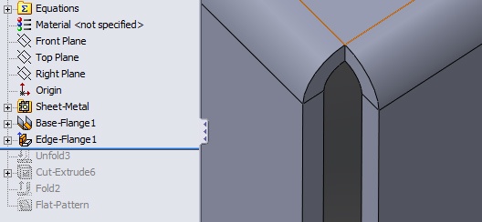

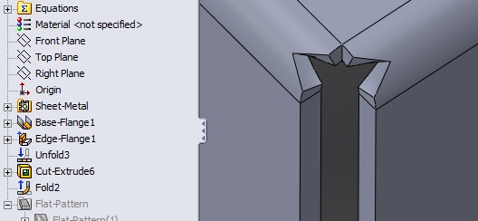

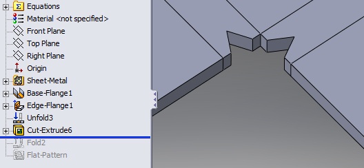

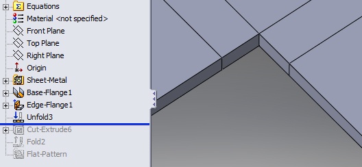

Cut notches at each bends extremities on a sheet metal part for laser cut
Following this thread:
Here is a macro to add notches at each bends extremities on a sheet metal part.
It will add an Unfold and fold feature, and create a cut feature with fully defined triangles.
