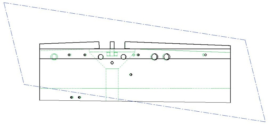

Pictures this :
- make a section view that is not pure horizontal or vertical
- result is a view that is crooked, which you can straighten out but using" align horizontal edge". IF you're lucky it will not only be horizontal aligned but even right side up
- now if you want to make a crop view of it and you want to do that by using a rectangle then you'll noticed that your rectangle ends up being aligned according to the enternal x,z axis of the view and thus it's not horizontal.
and even then the edge of the actual crop is not parallel to the edge of the wanted crop

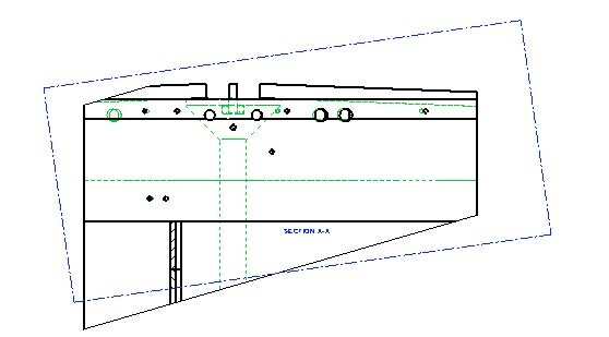

- you could try to just draw a rectangle by drawing the 4 sides yourself and making sure that they are ± horizontal and vertical and then making a crop of it but.... the end result is still tilted.

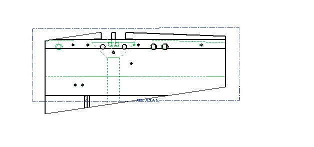

-so if I want to have that view cropped in a seemingly straight way I have to futz around with it so as to have a shape that is complimentary to the angle that it will use to actually  crop.
If there's something I'm overlooking I'm all ears.
