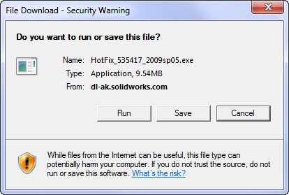

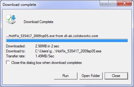

2) Select whether Run or Save the hotfix. Use Save if you are applying the hotfix to more than one computer.

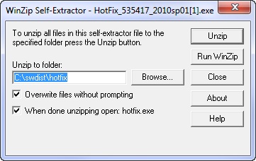

3) Select Run to extract the hotfix.
4) Select Run again to accept the warning, if shown (dependant on security settings).
5) Unzip the files and the hotfix will be applied.

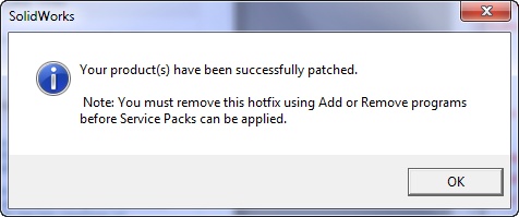

6) Patch complete. Note: You will need to uninstall this patch before applying
SolidWorks 2009 SP5.1, SolidWorks 2010 SP2.1 or higher.
If you do not get this confirmation message, check to see if you have selected the correct hotfix for your installed version of SolidWorks.
