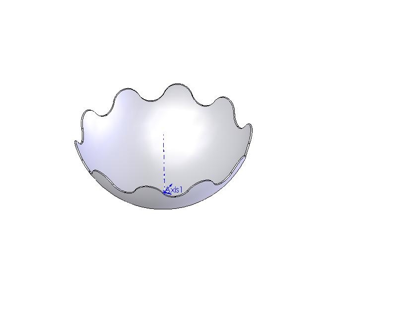

I want to create a bowel ending with 3d curvature, but withperfect symmetry, what is the best way to build the 3d curve?

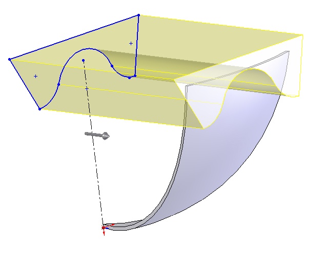

1.I created a profile on the right plane
2.Revolved it 360/6
3.Cut the curvature from the front plane
4.Finally I patterned it.
