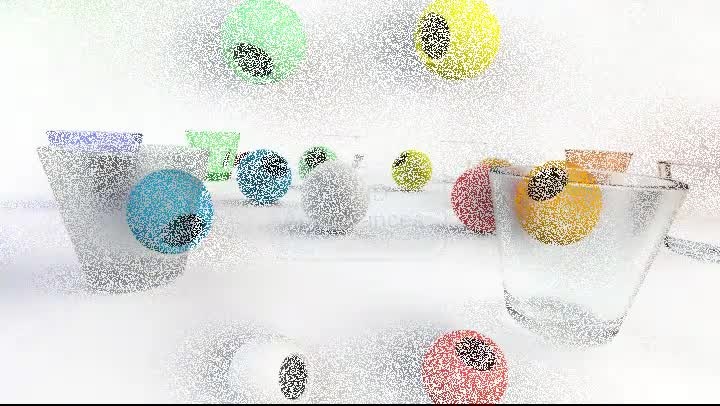

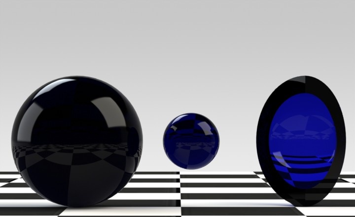

We have added a handful of new appearances; 1 set was there in the standalone (thick glass appearances.   Some could be downloaded from Modo's PV 360 site (gemstones).  And the Solids are just generally useful if all you need is a diffuse surface.  no more having to apply a plastic and then turn off reflections, specularity, etc.  So again, we have THICK GLOSS glass appearances.  There's a THICK GLOSS category under glass now.  Please understand the size of your geometry directly affects how much of the glass you see through.  In the attached image referring to Thick Gloss, the sphere on the left is an 8 inch diameter ball and you'll see it is entirely black.  GEMSTONES are found under the Organic category.  And Solids are a folder themslves.  Attached a small video showing a render of them in various spots.
