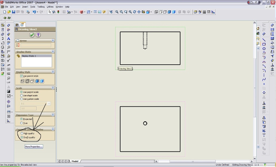

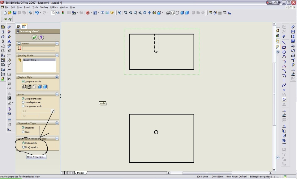

Hi all,
We've had a problem from time to time (about 10% of the time)where cosmetic thread with callout is selected in the hole wizardoptions, but the actual cosmetic thread does not show up in thedetail drawing when you insert model items. In the past to fix itwe have gone back to the hole wizard, turned off the cosmeticthread, exited the hole wizard, edited the hole wizard again, andturned the cosmetic thread with callout back on. Then it woulddisplay properly when you insert model items. However, now thatwe've upgraded SW 2007 to SP 5 it seems that some parts will notdisplay any cosmetic threads in the detail views no matter what youdo. We just upgraded a week or two ago and it seems this issueshowed up about the same time. Anyone run into this and find a workaround?
TIA!
