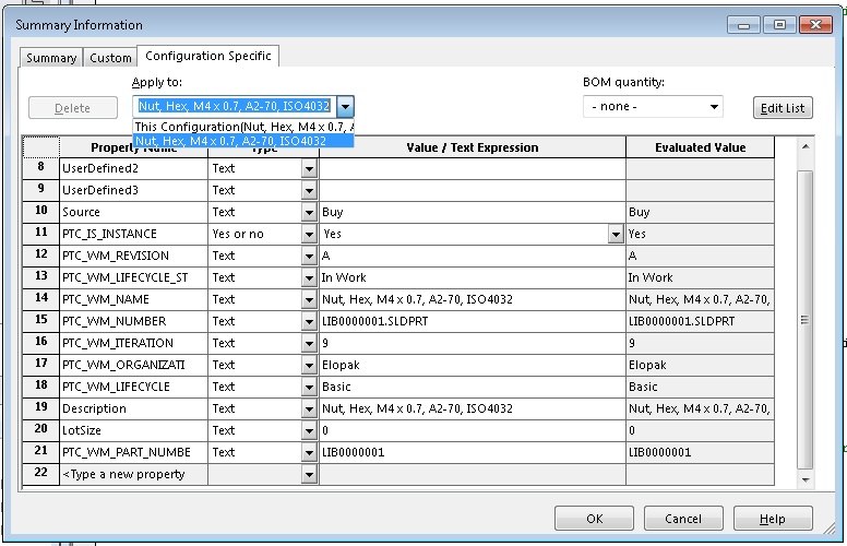

I working an a macro to extract configurations from a aesigntable Part. Compareable to the famous ConfigRipper.
Unfortunately I'm not a programmer on daily basis but found enough ideas for getting so far and now
the only thing missing is:
I'm not able to copy the configuration specific properties to the custom properties and after that delete all configuration specific properties.

There are 22 config specific properties, but Ubound always states there are 38 and the deleteing process runs into an error. It somehow seems that the properties are counted twice
Can someone give me a hint, what I did wrong here?
Regards
