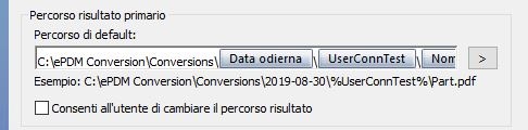

Associate the List "Convert_User" to variable "UserConnTest" (Image 1).

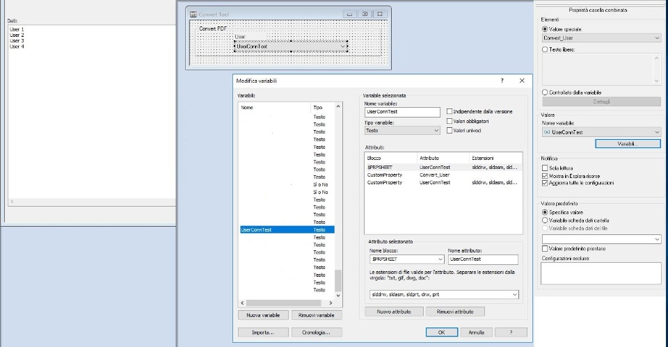

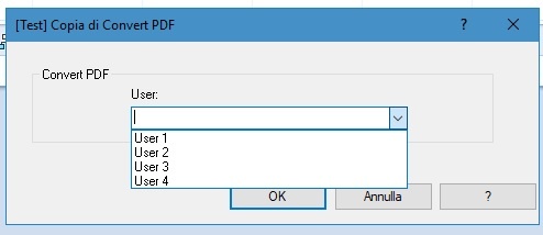

Created the "Operations" to convert to PDF format (Image 2/Image 3).

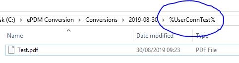

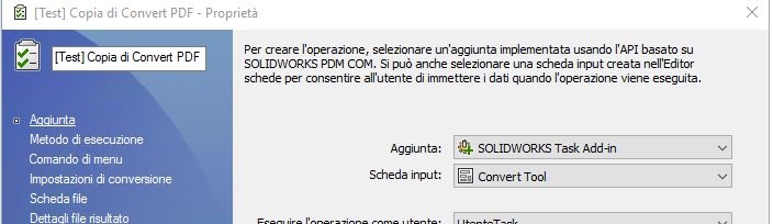

When I launch the convertion tool (Image 4), choosing a user (for example User 2), the process completes successfully, but in the save path of the converted file, instead of creating the folder with name of the user "User 2" the folder %UserConnTest% is created (Image 5).
