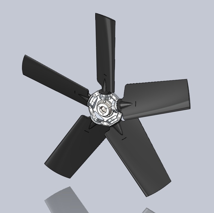

Attached is a compressed file (WinZIP) which contain a complete assembly for a Axial Fan Rotor which was produced using a STEP file imported into SW.  The model is done using a HYBRID methodology (in context top-down and bottom-up, simultaneously), which is driven by relations and equations inside some reference geometry sketches and then drive by a "configurator" design table.

Enter the desired parameters (inside the limits indicated in the table) and close the design table.  The model will automatically rebuild to the new values, changing the length of the blades to fit the new values for Fan Rotor Diameter, changing the number of blades and creating a new HUB to match and positioning the blades on the new Pitch Angle you indicate.
Them take a look in detail of the parts and you will see that all of them are "imported" objects created from a STEP file, see how the HUB and the Blades have been modified to be able to use them as "top-down" parametric parts.
