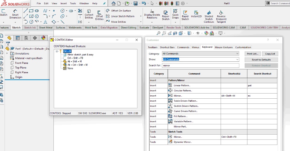

Added Always On Top (AOT) feature to CONTEKS Editor to allow the editor and SW to sit side by side when editing keyboard shortcuts (see the screen shot below).

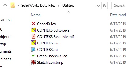

To install all of the files necessary (see below) for CONTEKS, run the attached “CONTEKS Setup.exe”.
The Read Me PDF file, shown above installed with the other CONTEKS files, is the same PDF file attached here, separate from the attached setup exe so you can review CONTEKS before installing.
No modifications are made to your computer during (or after) CONTEKS installation.
CONTEKS does not alter your SolidWorks installation either, other than the keyboard shortcuts that you create.

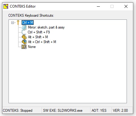

CONTEKS is the name of the program, but it is also the name for the data: a combination of a Master key; an optional description and keyboard shortcuts for one or more of the SolidWorks contexts as shown in the first screen shot. CONTEKS reads its data and CONTEKS Editor stores its data in CONTEKS.ini.
CONTEKS (the data) are created and managed using CONTEKS Editor.

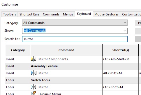

Create keyboard shortcuts in SolidWorks. Use the hard to reach, hard to remember keystroke combinations as you won’t be pressing these shortcuts and you won’t have to remember them.
Using CONTEKS Editor, a standalone program separate from CONTEKS, assign these SolidWorks keystrokes to the corresponding context under the appropriate Master key:
With the Always On Top (AOT) feature of CONTEKS Editor (v2.00+) turned on, CONTEKS Editor can be put next to SW's Customize dialog for easier keyboard shortcut coordination:
The Ctrl + M CONTEKS shown above is included with the installation.
