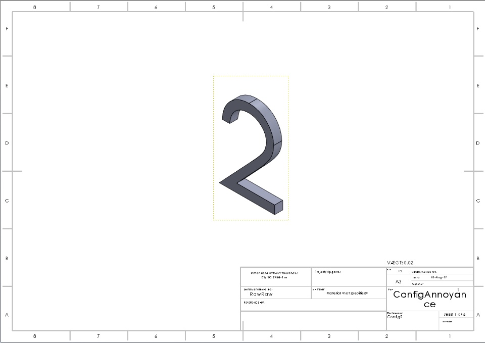

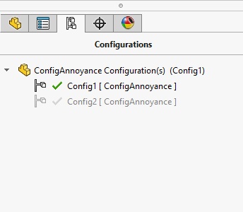

I have one part with several different configurations. due to this part being a module in a greater modular assembly system.

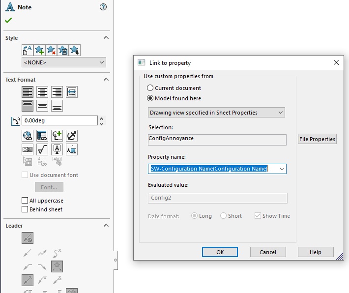

In the drawing of this part, I've made a reference to the configuration name, placed in the title block.

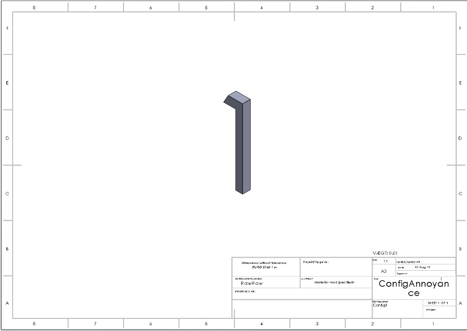

I'm trying to accomplish that for every sheet in the drawing, I can have a different configuration, and that it shows the configuration name in the title block like this.
But when I have Config1 as the first sheet, every sheet says "Config1" and if I rearrange the sheets to have Config2 as the first, it shows "Config2" on all sheets.
anyone have an idea how to accomplish this?
