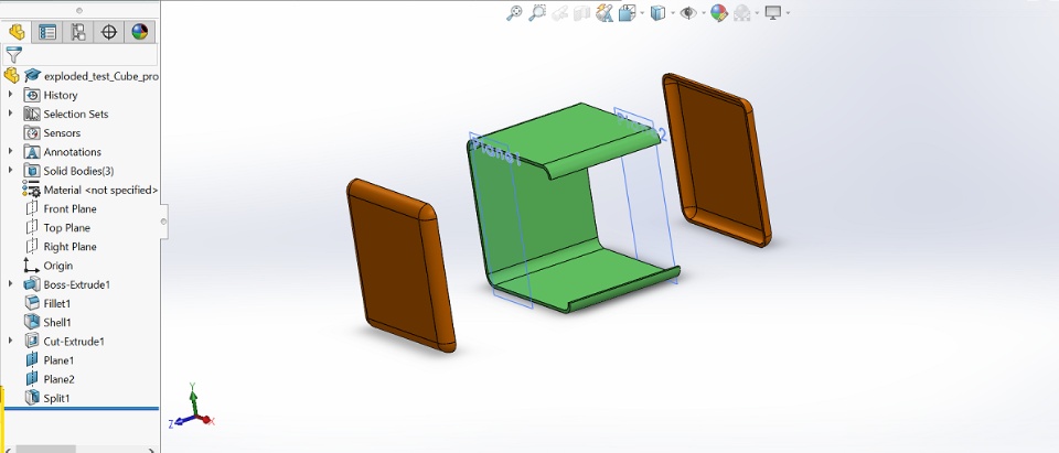

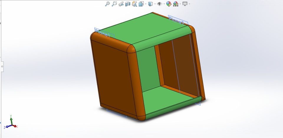

I've created a shelled-out cube with filleted corners and then used the split command to detach 2 sides. I've saved out the left & right sides and the middle section to their own individual part files, using the Split command. I've found that If I make changes in the "parent" file, this leads to the changes updating in the "child" files.

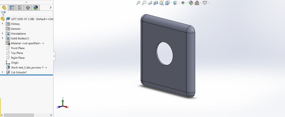

**However, when I cut a hole in the left side in its own file, this did not filter back to the parent, even with rebuilding...

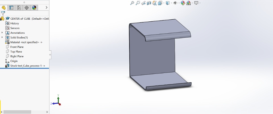

Middle Section split off in own file:

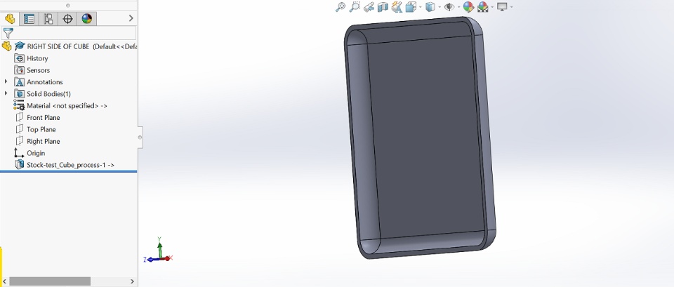

Right Side split off in own file:
Left side split off in own file (with extruded cut hole added later):
