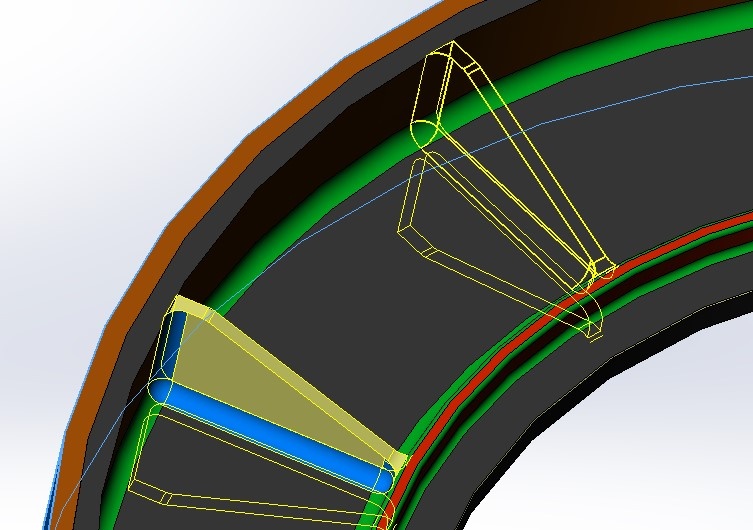

I have a parametric model that I've been developing which is all controlled through a design table. I'm running into one issue though with pattern for a gusset and the fillets for that gusset. The circular pattern works just fine when I pattern the gusset feature, but when I add the fillet feature it shows it fine in the preview but throws an error. As soon as I remove the fillet from the pattern it works fine and I can also manually apply the fillet outside of the pattern just fine so I have no idea what it is.
