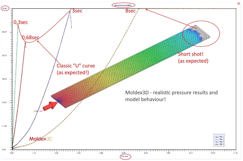

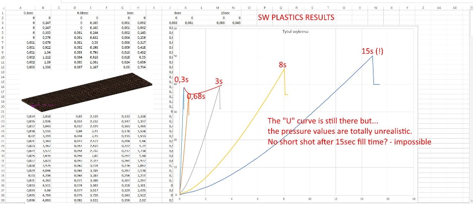

Here is my last example base on which you can clearly see that Plastics cannot properly simulate even the basic behavior of injection molding process.
The same example solved in Moldex3D gives you expectable results from the very beginning.
Same material (Viscosity,PVT, mechanical properties etc), same model, very similar mesh (BLM with two skin layers - 5 elements through thickness), same process:
DSS - shame on you!
