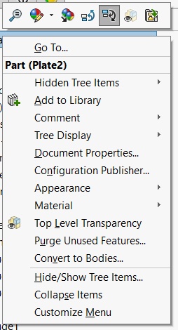

The SolidWorks 2018 help mentions:
In the FeatureManager design tree, right-click the first item (part or assembly).
Click one or both of the following: Dynamic Reference Visualization (Parent), ...
I'm not able to find those in my FeatureManager tree (SW 2018 SP 2.0):
However, with the help of the Great CommandManager, I found them under:
Expecting:
- Help should reflect the reality of the current version of SolidWorks user interface
Actual:
- The steps in the Help were not correct, at least on my installation.
