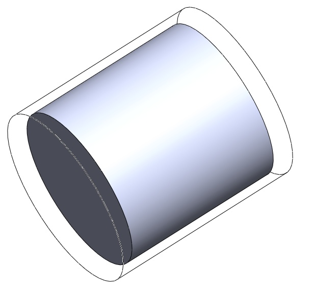

I like new option to create bounding box. Here are my options to improve the feature:
You can see two bodies in picture below
the first body represents part itself
second body (displayed in wireframe mode) represents bounding box with offset.
The offset would be for both option prismatic and turned parts.
prismatic - add offset in 6 directions or set symmetric
turned - add offset in 3 directions
Benefits of this enhancement would be:
1. use it as custom property for stock column (BOM, title block etc.) in drawing
2. no mistakes when ordering stock material for manufacturing
3. better bounding box representation if a part is created using rotation.
