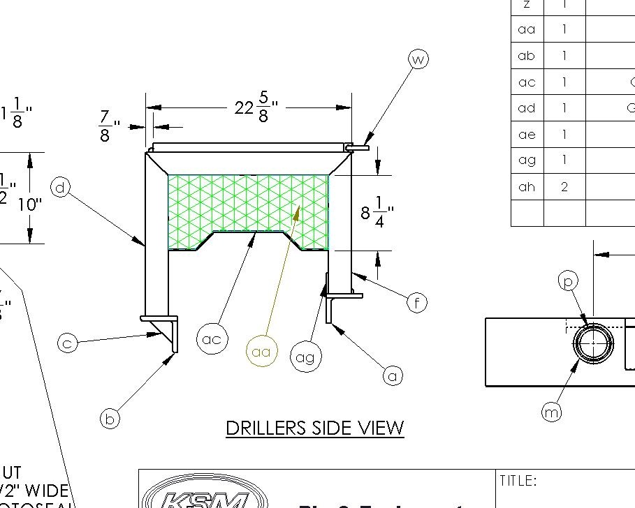

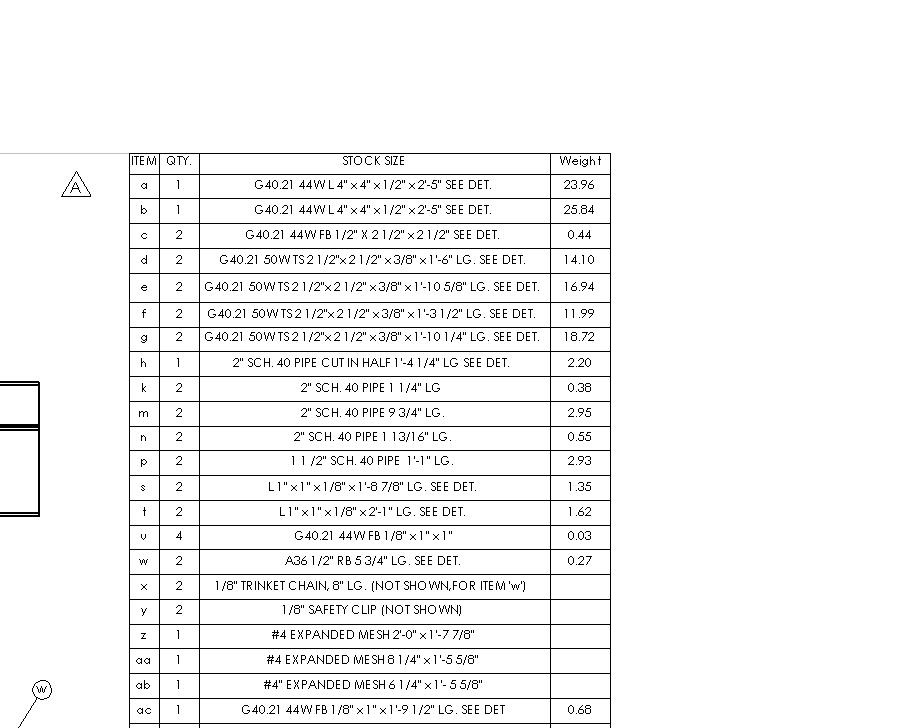

Does anyone know if it is possible to redo a BOM so that itdisplays a,b,c,d.... rather than 1,2,3,4......?
It helps keep the confusion down in the shop or someone mixing upqty 2 of item 6 or qty 6 or item 2... etc.
This would also greatly help with our filing structure
I have tired a few things but it hasn't worked.
Thanks
